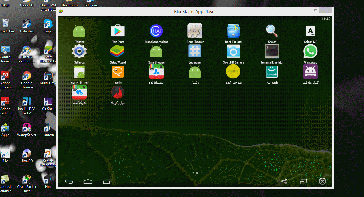

Well, this class has several animations, which I wrote to animate, for example. Because this code is written twice, both upper and lower order items are animated.
Sample "
