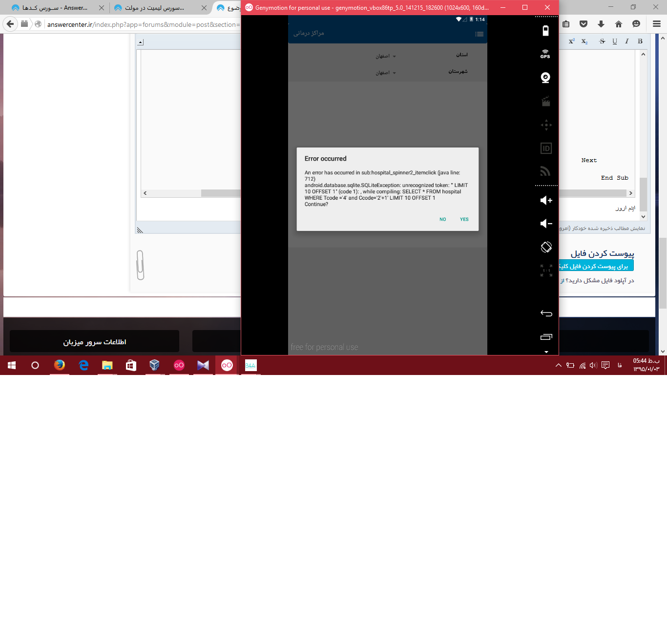

amir mahdizadeh 109 ارسال شده در 3 فروردین، ۱۳۹۵ اشتراک گذاری ارسال شده در 3 فروردین، ۱۳۹۵ Sub Spinner2_ItemClick (Position As Int, Value As Object) cur1 = sql1.ExecQuery("SELECT * FROM hospital WHERE Tcode ='"&tcode& "' and Ccode='"&Position&"'+1' LIMIT 10 OFFSET "&offset&" ") ScrollView1.Panel.RemoveAllViews stop = 0 For i = 1 To cur1.RowCount-1 cur1.Position = i Dim p As Panel p.Initialize("p") ScrollView1.Panel.AddView(p,0,stop,100%x,100%y) stop = stop + 300dip p.LoadLayout("listhospital") tell.Tag = i website.Tag = i name1.Text = " نام بیمارستان" name1.Typeface = Typeface.LoadFromAssets("KoodakB.ttf") name1.TextColor = Colors.Black name1.Gravity = Gravity.RIGHT name1.TextSize = 14 name.Text = cur1.GetString("Hname") name.Typeface = Typeface.LoadFromAssets("KoodakB.ttf") name.TextColor = Colors.Black name.Gravity = Gravity.RIGHT name.TextSize = 14 addres1.Text = " آدرس" addres1.Typeface = Typeface.LoadFromAssets("KoodakB.ttf") addres1.TextColor = Colors.Black addres1.Gravity = Gravity.RIGHT addres1.TextSize = 14 addres.Text = cur1.GetString("discription") addres.Typeface = Typeface.LoadFromAssets("KoodakB.ttf") addres.TextColor = Colors.Black addres.Gravity = Gravity.RIGHT addres.TextSize = 14 tell1.Text = " تلفن تماس" tell1.Typeface = Typeface.LoadFromAssets("KoodakB.ttf") tell1.TextColor = Colors.Black tell1.Gravity = Gravity.RIGHT tell1.TextSize = 14 tell.Text = cur1.GetString("tell") tell.Typeface = Typeface.LoadFromAssets("KoodakB.ttf") tell.TextColor = Colors.Black tell.Gravity = Gravity.LEFT tell.TextSize = 14 website1.Text = " وبسایت" website1.Typeface = Typeface.LoadFromAssets("KoodakB.ttf") website1.TextColor = Colors.Black website1.Gravity = Gravity.RIGHT website1.TextSize = 14 website.Text = cur1.GetString("website") website.Typeface = Typeface.LoadFromAssets("timesi.ttf") website.TextColor = Colors.Black website.Gravity = Gravity.LEFT website.TextSize = 14 ScrollView1.Panel.Height=stop Next End Sub Sub ScrollView1_ScrollChanged(Position As Int) If ScrollView1.ScrollPosition + ScrollView1.Height = ScrollView1.Panel.Height Then offset = offset + 10 cur1 = sql1.ExecQuery("SELECT * FROM hospital WHERE Tcode ='"&tcode& "'and Ccode='"&Position&"'+1' and LIMIT 10 OFFSET "&offset&" ") For i = 1 To cur1.RowCount-1 cur1.Position = i Dim p As Panel p.Initialize("p") ScrollView1.Panel.AddView(p,0,stop,100%x,100%y) stop = stop + 300dip p.LoadLayout("listhospital") tell.Tag = i website.Tag = i name1.Text = " نام بیمارستان" name1.Typeface = Typeface.LoadFromAssets("KoodakB.ttf") name1.TextColor = Colors.Black name1.Gravity = Gravity.RIGHT name1.TextSize = 14 name.Text = cur1.GetString("Hname") name.Typeface = Typeface.LoadFromAssets("KoodakB.ttf") name.TextColor = Colors.Black name.Gravity = Gravity.RIGHT name.TextSize = 14 addres1.Text = " آدرس" addres1.Typeface = Typeface.LoadFromAssets("KoodakB.ttf") addres1.TextColor = Colors.Black addres1.Gravity = Gravity.RIGHT addres1.TextSize = 14 addres.Text = cur1.GetString("discription") addres.Typeface = Typeface.LoadFromAssets("KoodakB.ttf") addres.TextColor = Colors.Black addres.Gravity = Gravity.RIGHT addres.TextSize = 14 tell1.Text = " تلفن تماس" tell1.Typeface = Typeface.LoadFromAssets("KoodakB.ttf") tell1.TextColor = Colors.Black tell1.Gravity = Gravity.RIGHT tell1.TextSize = 14 tell.Text = cur1.GetString("tell") tell.Typeface = Typeface.LoadFromAssets("KoodakB.ttf") tell.TextColor = Colors.Black tell.Gravity = Gravity.LEFT tell.TextSize = 14 website1.Text = " وبسایت" website1.Typeface = Typeface.LoadFromAssets("KoodakB.ttf") website1.TextColor = Colors.Black website1.Gravity = Gravity.RIGHT website1.TextSize = 14 website.Text = cur1.GetString("website") website.Typeface = Typeface.LoadFromAssets("timesi.ttf") website.TextColor = Colors.Black website.Gravity = Gravity.LEFT website.TextSize = 14 ScrollView1.Panel.Height=stop Next End If End Sub لینک ارسال به اشتراک گذاری در سایت های دیگر تنظیمات بیشتر اشتراک گذاری ...
مهدی ایزدی 9,203 ارسال شده در 3 فروردین، ۱۳۹۵ اشتراک گذاری ارسال شده در 3 فروردین، ۱۳۹۵ اینم ارور کووووووو؟ لینک ارسال به اشتراک گذاری در سایت های دیگر تنظیمات بیشتر اشتراک گذاری ...
amir mahdizadeh 109 ارسال شده در 3 فروردین، ۱۳۹۵ سازنده اشتراک گذاری ارسال شده در 3 فروردین، ۱۳۹۵ کووووووو؟ http://s7.picofile.c...84/Untitled.png لینک ارسال به اشتراک گذاری در سایت های دیگر تنظیمات بیشتر اشتراک گذاری ...
Farzad Musavi 576 ارسال شده در 3 فروردین، ۱۳۹۵ اشتراک گذاری ارسال شده در 3 فروردین، ۱۳۹۵ پست اول رو ویرایش کردید کدها بهم ریختلطفا مجددا ویرایش کنید به صورت کامل و از اول بنویسید cur1 = sql1.ExecQuery("SELECT * FROM hospital WHERE Tcode ='"&tcode& "' and Ccode='"&Position&"'+1' LIMIT 10 OFFSET "&offset&" ") این خط رو با این کدی که من میدم عوض کن cur1 = sql1.ExecQuery("SELECT * FROM hospital WHERE Tcode ='"&tcode& "' and Ccode='"&(Position+1) &"' LIMIT 10 OFFSET "&offset&" ") لینک ارسال به اشتراک گذاری در سایت های دیگر تنظیمات بیشتر اشتراک گذاری ...
amir mahdizadeh 109 ارسال شده در 3 فروردین، ۱۳۹۵ سازنده اشتراک گذاری ارسال شده در 3 فروردین، ۱۳۹۵ پست اول رو ویرایش کردید کدها بهم ریخت لطفا مجددا ویرایش کنید به صورت کامل و از اول بنویسید cur1 = sql1.ExecQuery("SELECT * FROM hospital WHERE Tcode ='"&tcode& "' and Ccode='"&Position&"'+1' LIMIT 10 OFFSET "&offset&" ") این خط رو با این کدی که من میدم عوض کن cur1 = sql1.ExecQuery("SELECT * FROM hospital WHERE Tcode ='"&tcode& "' and Ccode='"&(Position+1) &"' LIMIT 10 OFFSET "&offset&" ") ممنون فرزاد جون با این کد دیگه ارور نمیده اما فقط 9 تای اول رو چاپ میکنه باید چکار کنم؟ لینک ارسال به اشتراک گذاری در سایت های دیگر تنظیمات بیشتر اشتراک گذاری ...
Farzad Musavi 576 ارسال شده در 3 فروردین، ۱۳۹۵ اشتراک گذاری ارسال شده در 3 فروردین، ۱۳۹۵ ممنون فرزاد جون با این کد دیگه ارور نمیده اما فقط 9 تای اول رو چاپ میکنه باید چکار کنم؟ 10 رو باید تغییر بدی دگ لینک ارسال به اشتراک گذاری در سایت های دیگر تنظیمات بیشتر اشتراک گذاری ...
amir mahdizadeh 109 ارسال شده در 3 فروردین، ۱۳۹۵ سازنده اشتراک گذاری ارسال شده در 3 فروردین، ۱۳۹۵ منظورم اینه که فقط 9 تاشو چاپ میکنه بقیه رو دیگه نشون نمیده به جای 10 عدد 11 رو گذاشتم الان 10 تاشو نشون میده اما به اخرش که میرسه بقیه رو لود نمیکنه 10 رو باید تغییر بدی دگ لینک ارسال به اشتراک گذاری در سایت های دیگر تنظیمات بیشتر اشتراک گذاری ...
Farzad Musavi 576 ارسال شده در 3 فروردین، ۱۳۹۵ اشتراک گذاری ارسال شده در 3 فروردین، ۱۳۹۵ منظورم اینه که فقط 9 تاشو چاپ میکنه بقیه رو دیگه نشون نمیده به جای 10 عدد 11 رو گذاشتم الان 10 تاشو نشون میده اما به اخرش که میرسه بقیه رو لود نمیکنه اول اینکه i رو مساوی 0 بزار تا مجبور نشی 11 بزاری از طرفی هم یه آیتمت خونده نمیشه اونجوری مشکل اسکرولتم بخاطر اینه که Position برای اسپینره فک کنم و تو ساب اسکرول کار نمیکنه بیا Position رو تو یه متغییر بریز بعد تو اسکرول ویو ازش استفاده کن لینک ارسال به اشتراک گذاری در سایت های دیگر تنظیمات بیشتر اشتراک گذاری ...
amir mahdizadeh 109 ارسال شده در 3 فروردین، ۱۳۹۵ سازنده اشتراک گذاری ارسال شده در 3 فروردین، ۱۳۹۵ اول اینکه i رو مساوی 0 بزار تا مجبور نشی 11 بزاری از طرفی هم یه آیتمت خونده نمیشه اونجوری مشکل اسکرولتم بخاطر اینه که Position برای اسپینره فک کنم و تو ساب اسکرول کار نمیکنه بیا Position رو تو یه متغییر بریز بعد تو اسکرول ویو ازش استفاده کن از پیگیریت ممنون اما با عرض معذرت یکم گیج شدم میشه بیشتر توضیح بدین؟؟ شرمنده لینک ارسال به اشتراک گذاری در سایت های دیگر تنظیمات بیشتر اشتراک گذاری ...
Farzad Musavi 576 ارسال شده در 3 فروردین، ۱۳۹۵ اشتراک گذاری ارسال شده در 3 فروردین، ۱۳۹۵ توی ساب گلوبال بنویس dim ff as int توی ساب اسپینر بنویس ff=position توی ساب اسکرول ویو هم اون خط cur رو با کد زیر جایگذین کن cur1 = sql1.ExecQuery("SELECT * FROM hospital WHERE Tcode ='"&tcode& "'and Ccode='"&(ff+1)&"' and LIMIT 10 OFFSET "&offset&" ") لینک ارسال به اشتراک گذاری در سایت های دیگر تنظیمات بیشتر اشتراک گذاری ...
amir mahdizadeh 109 ارسال شده در 3 فروردین، ۱۳۹۵ سازنده اشتراک گذاری ارسال شده در 3 فروردین، ۱۳۹۵ من این کد ها رو اعمال کردم درست شد اما بازم مشکل دارم تو این قضیه هر بار که یکی از ایتم های اسپینر رو انتخاب میکنم همه چیز درسته اما به صورت شانسی روی یه ایتم دیگه که کلیک می کنم پنل ها رو نشون نمیده باید چکارش کنم؟ ببخشید که اینقدر سوال میکنم چون تا به حال با این مسولهمواجه نشده بودم پیشاپیش ممنون از همه دوستان لینک ارسال به اشتراک گذاری در سایت های دیگر تنظیمات بیشتر اشتراک گذاری ...
Farzad Musavi 576 ارسال شده در 4 فروردین، ۱۳۹۵ اشتراک گذاری ارسال شده در 4 فروردین، ۱۳۹۵ من این کد ها رو اعمال کردم درست شد اما بازم مشکل دارم تو این قضیه هر بار که یکی از ایتم های اسپینر رو انتخاب میکنم همه چیز درسته اما به صورت شانسی روی یه ایتم دیگه که کلیک می کنم پنل ها رو نشون نمیده باید چکارش کنم؟ ببخشید که اینقدر سوال میکنم چون تا به حال با این مسولهمواجه نشده بودم پیشاپیش ممنون از همه دوستان من نمیدونم برنامت چیه اینارم از کدهایی که گذاشتی فهمیدم الان متوجه نشدی اشتباهتو مگه بقیه جاهارو خودت درست کن دگ لینک ارسال به اشتراک گذاری در سایت های دیگر تنظیمات بیشتر اشتراک گذاری ...
amir mahdizadeh 109 ارسال شده در 4 فروردین، ۱۳۹۵ سازنده اشتراک گذاری ارسال شده در 4 فروردین، ۱۳۹۵ اون قبلی ها رو همشو فهمیدم بعدش دو سه مشکل کوچیک دیگه هم داشت اونا رو هم رفع کردم اما مشکل اصلیم هنوز رفع نشده من 2 تا اسپینر دارم اولی واسه استان دومی واسه شهرستان ها وقتی استان و شهر رو انتخاب میکنم لیست بیمارستان های اون شهر رو در مولتی پنل نشون میده و من واسه سرعت بیشتر بهش لیمیت دادم مشکلم اینجاس که بار اول که یه شهر رو انتخاب میکنم دفعه بعدش اگه شهر دیگه رو انتخاب کنم محتویاتشو نشون نمیده ممنون میشم کمکم کنید لینک ارسال به اشتراک گذاری در سایت های دیگر تنظیمات بیشتر اشتراک گذاری ...
